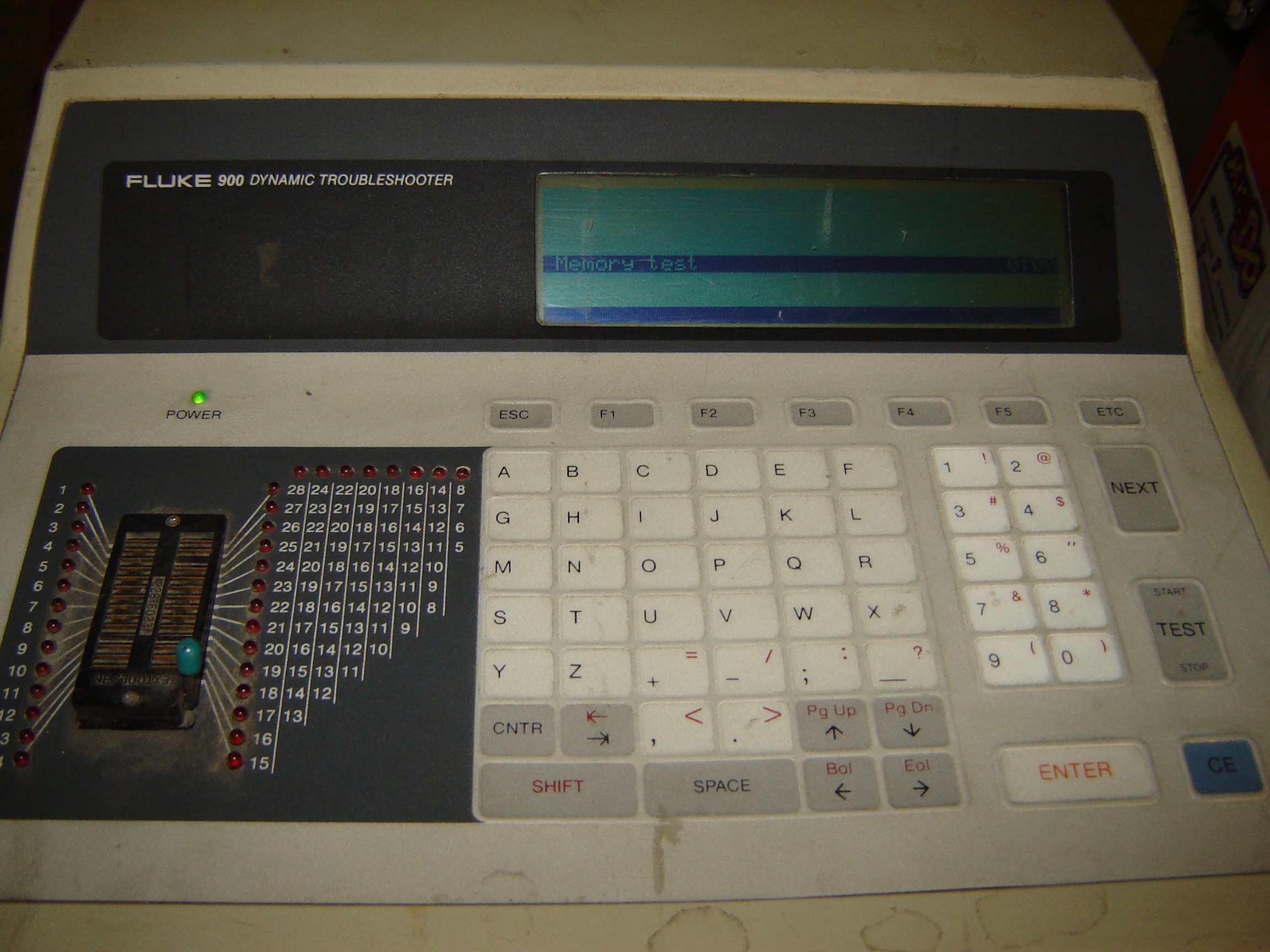

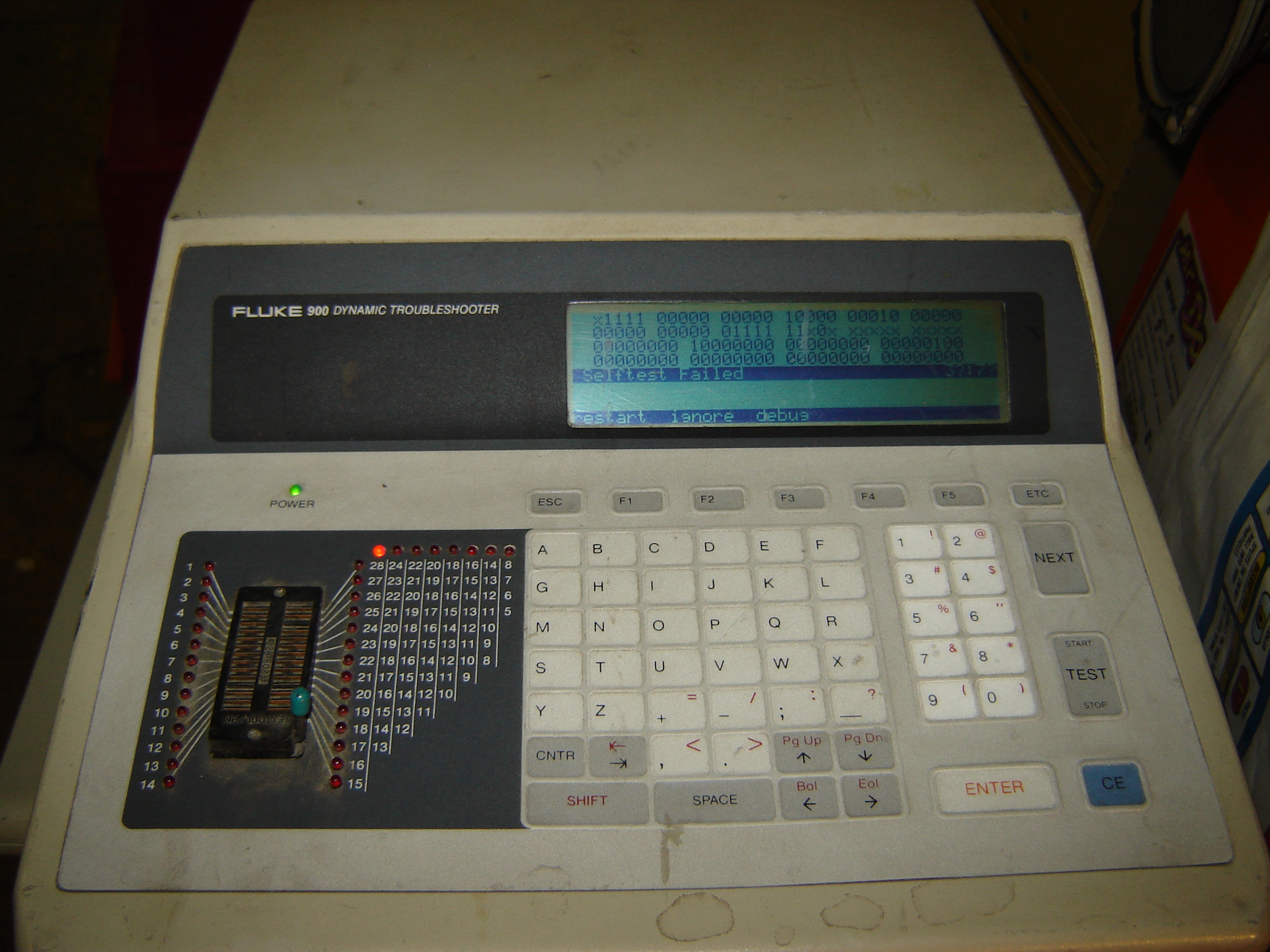

Hi Steve,
My unit does not pass self test as you can see from the photo. If I tell it to "ignore" it then does the self test again, going past the Memory test, and into the Hardware Test. Gets up to Hardware 56 and then the fail screen reappears.
I have two manuals for the machine and the operators book says to contact FLUKE to identify what the self test problem is...that is a lot of use!
PIctures included. I have no spare parts/accessories (that I know of!) for this 900 series unit.

Not to be confused with the dedicated CPU testers similar to the 9010a.
I have one and it is displaying failures on boot up, so I have been putting together my notes on what I have found as there is no service manual available. Is anybody else interested in this information, does anybody else have one that can send me details on the fault report they have?
