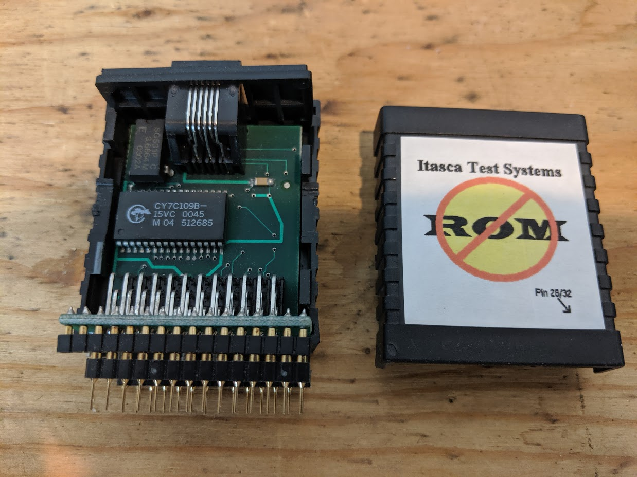

My vision is that I could have 8 of them plugged into all the EPROM sockets on a board like this.. 😊 Then I can live debug! [cid:image002.jpg@01D53E10.77CC3C50] -----Original Message----- From: Techtoolslist <techtoolslist-bounces@flippers.com> On Behalf Of Phillip Eaton Sent: Thursday, July 18, 2019 11:24 PM To: Technical Tools Mail List <techtoolslist@flippers.com> Subject: Re: [Techtoolslist] EPROM Emulator Questions We had something very similar at my company in the 90s, it was a bit smaller black grey potted block with an rs232 cable sticking out. Compared with the Dataman S3 and S4 we had, it was just as fast to use for emulation and much cheaper. I'd probably buy one if they were available again at the right price, but I don't have the capacity/capability to help create one unfortunately. On Fri, 19 Jul 2019, 05:03 Jess Askey, <jess@askey.org<mailto:jess@askey.org>> wrote:
Here is a picture of it and the innards... there is an older CPLD on
the other side of the PCB and it looks like it just writes the binary
content to the RAM (shown) and then it runs free with the ability to
monitor what is going on. The software supports the standard 24/28/32
pin configurations so you can make it work in anything from a 2716 up
to like a 27C010. I tried to get ahold of John Olsen who ran Itasca
(according to my instruction pamphlet) but he is no where to be found.
It's not terribly complicated. The plastic body is cheaply available.
[cid:image001.png@01D53DAC.12AC7920]

John's AdCOM question got me thinking a little bit....
So I have an old Itasca Systems NoROM Eprom emulator, it is sorta a
genius little device because it is literally a small black 'Extended 32-Pin DIP'
and it only sticks up about 1.5 Inches. It has a Serial Port built in
with an RJ-12 (6/8Pin?) so the cable is lightweight. They stopped
making it in
2000 or so and I really just want to make more of them (functionally).
Some improvements would be...
1. Switch to USB + daisy chain so you can literally have dozens of
these on a PCB if really needed.
2. An improved interface for sending data to the device(s) 3. Nice in
place debugging and sniffing
Anyone interested in working on a project like this with me? I can do
the software side but Im not really there on the FPGA end. I have good
details on the packaging of the ITASCA one and I can post pics if you
want. They no longer make it or are in existence so I don't want to
duplicate it per se, just build something with core functionality in the same form factor.
Email me if interested.... jess@askey.org<mailto:jess@askey.org<mailto:jess@askey.org%3cmailto:jess@askey.org>>

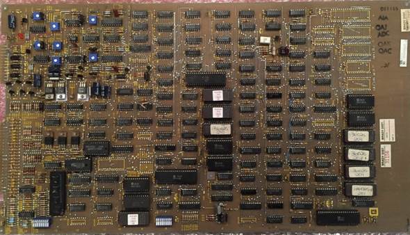

Maybe something like this little guy Jess? https://i.imgur.com/K8tsyhm.png I've been using a handful of these for a couple of years now on Atari vector boards without issue. This photo is the earliest prototype and supports 2516/2716/2532/2732. It's good for development but was really designed as a solution for long term eprom replacement than as an emulator. A small upgrade could possibly shift this to full "emulator" supporting more aggressive development work. On 7/19/2019 8:00 AM, Jess Askey wrote:

YES!! Need that USB to be vertical maybe if there are a bunch of them... I *will be happy* to write software for it if needed and you want... I like UI's so an open source .NET app would make that thing Niiiiice! Drag and Drop, real time monitoring, byte editing, Im happy to be a proto tester. In my world Im currently in 28-pin land to.... 2764-27256... so I may need to wait for the next generation. 😊 -----Original Message----- From: Techtoolslist <techtoolslist-bounces@flippers.com> On Behalf Of techtools-steve Sent: Friday, July 19, 2019 12:24 PM To: Technical Tools Mail List <techtoolslist@flippers.com> Subject: Re: [Techtoolslist] EPROM Emulator Questions Maybe something like this little guy Jess? https://i.imgur.com/K8tsyhm.png I've been using a handful of these for a couple of years now on Atari vector boards without issue. This photo is the earliest prototype and supports 2516/2716/2532/2732. It's good for development but was really designed as a solution for long term eprom replacement than as an emulator. A small upgrade could possibly shift this to full "emulator" supporting more aggressive development work. On 7/19/2019 8:00 AM, Jess Askey wrote:

Interesting... i like the fact it has a Pi in it, so you could run a compiler on it, and make test code, and then upload to the sram chip... Jess's solution is awesome.. super small.. but not sure it would ever be released.. I did order one of the EEprom Emulators from ebay, i probably should pull it out and actually play with it haha... William Stillwell Board Member - Inspiration labs, Inc. a 501c3 organization Board Member & Co-Founder - Byte Amusement Group // Free Play Florida Arcade & Pinball Show a 501c3 organization On Mon, Oct 14, 2019 at 4:00 PM John Robertson <jrr@flippers.com> wrote:
One could make an emulator using a Raspberry Pi:
https://www.sbprojects.net/projects/pi-epsim/
All you need is to make a PCB using KiCad or similar.
Pis are pretty cheap, and I suspect you could compress the design onto a blob that fits on the UUT socket.
