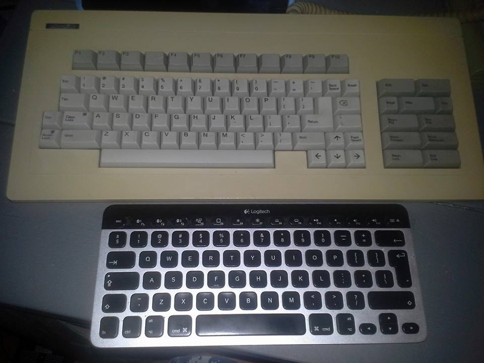

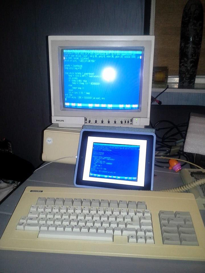

Thanks John. I'm familiar with the above site. Cool stuff. Does anyone have a decent picture of the 9100 programming keyboard? I know David produced an adapter for using IBM but curious if there is a picture of the real-deal. My google-fu didn't come up with anything. thanks!

Andre, have you managed a Bluetooth connection to the 9100? As for images, etc. TTL can handle message sizes up to 2000KB (2MB), so you can attach photos and small files to messages. John :-#)# On 11/14/2015 1:12 AM, Andre Huijts wrote:
Here pics of mine, I hope these pics will arrive, normally pics don't show up on this mail digest.

I'd be interested in buying a keyboard if anyone has a spare. Or one of the adapters if they are still available. Thanks Tony On Nov 14, 2015 1:29 AM, "Andre Huijts" <a.huijts@upcmail.nl> wrote:

I see now the pics are not very clear/sharp. I’ll take some with my proper camera and post.
