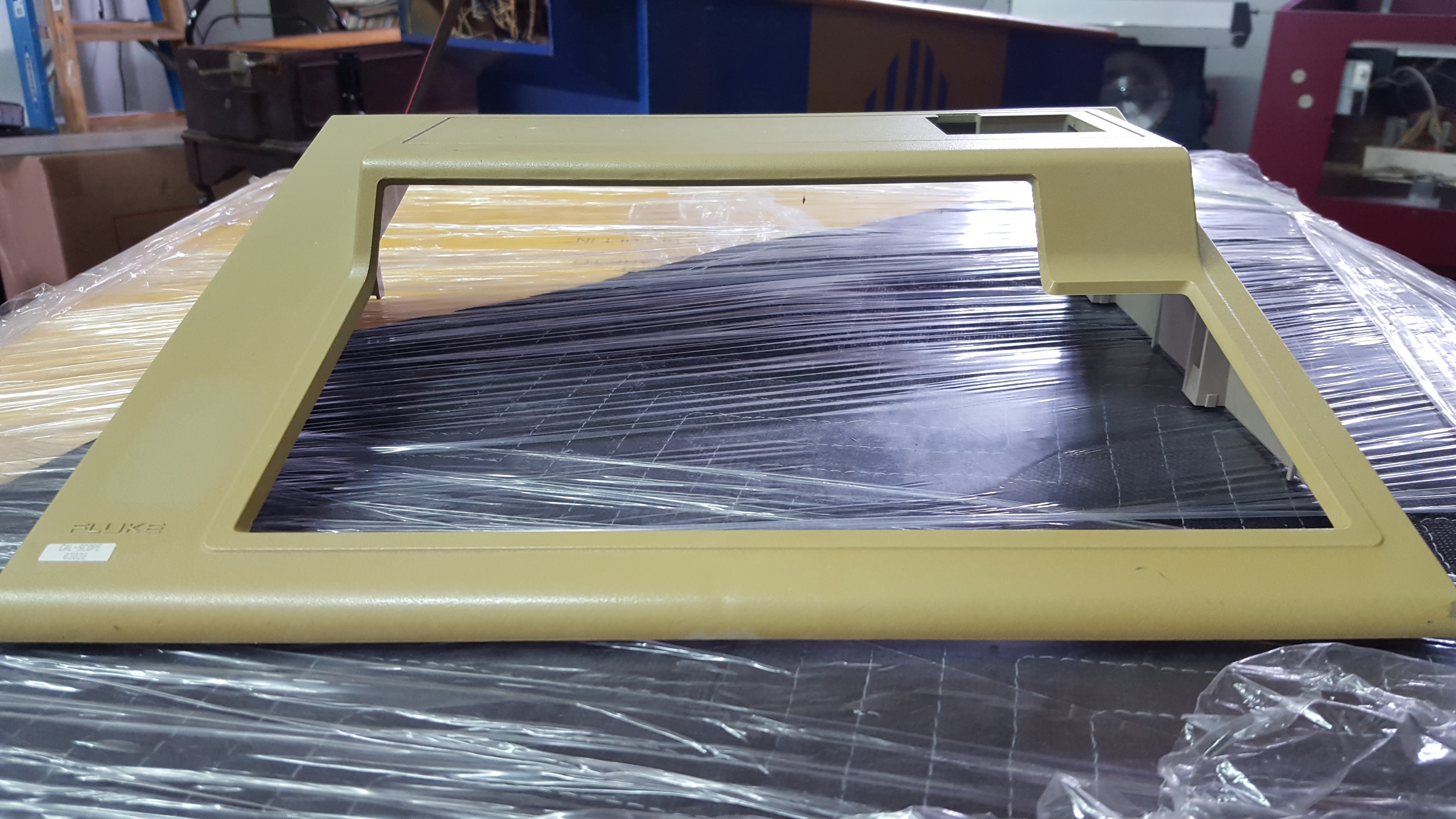

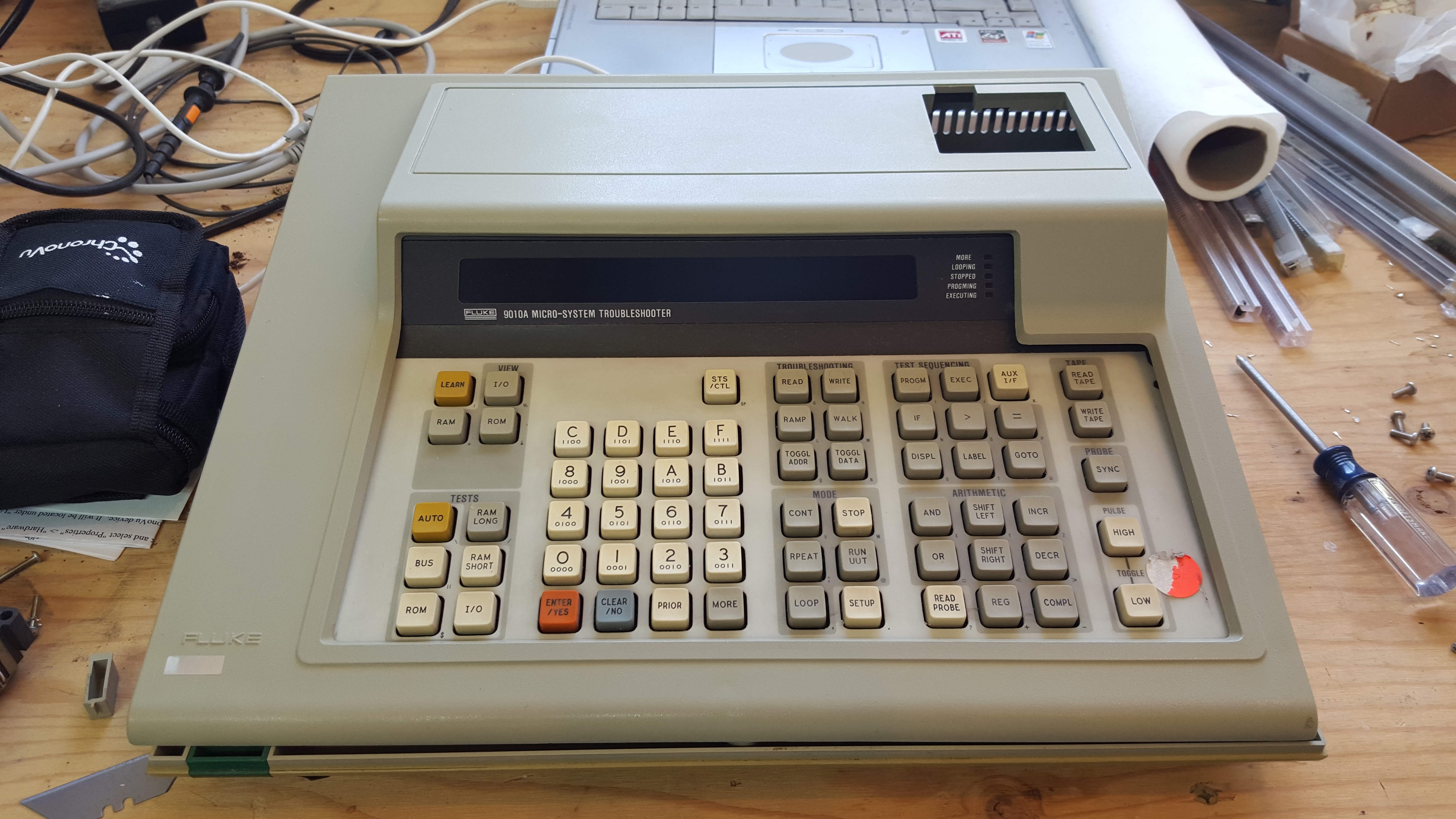

Hey everyone... Seems like there has been lots of information out there for a few years on how to use Peroxide based bleaches along with UV in order to remove the 'yellow' from old plastics. I decided to try this on my 9010A because it had been sitting idle for quite a long time in the sun of Colorado and was pretty badly yellowed... Attached is a before and after photos if you are interested... it took me about 4 hours to do this and I would say the results are pretty good. I did have to do some extra steps as the peroxide cream I used (I had the '20%' strength version from Sally Beauty supply, and probably should have tried to find the 40% cream instead) left sort of a mottled bleaching pattern... I ended up bleaching with the peroxide cream twice with a total time in the sun of about 5 hours. Afterwards, definitely some improvements but it is inconsistent and actually didn't look that great. I still had some deep yellow areas. I decided to pull out the acetone at that point to see if I could potentially blend in the differences and it actually just seemed to strip off the yellow layer quite nicely. I used paper towels and acetone a few time to get things looking good, then some Novus plastic polish and that was where I stopped. Anyway, looks much nicer... time to try it on my Data IO 29B now! _______________________________________________ Techtoolslist mailing list Techtoolslist@flippers.com https://pairlist7.pair.net/mailman/listinfo/techtoolslist FTP site is: ftp://ttl.arcadetech.org/TTL/Test_Equipment Archive site: http://seven.pairlist.net/pipermail/techtoolslist/

Seems like there has been lots of information out there for a few years on how to use Peroxide based bleaches along with UV in order to remove the 'yellow' from old plastics. I decided to try this on my 9010A because it had been sitting idle for quite a long time in the sun of Colorado and was pretty badly yellowed... Attached is a before and after photos if you are interested... it took me about 4 hours to do this and I would say the results are pretty good. I did have to do some extra steps as the peroxide cream I used (I had the '20%' strength version from Sally Beauty supply, and probably should have tried to find the 40% cream instead) left sort of a mottled bleaching pattern... I ended up bleaching with the peroxide cream twice with a total time in the sun of about 5 hours. Afterwards, definitely some improvements but it is inconsistent and actually didn't look that great. I still had some deep yellow areas. I decided to pull out the acetone at that point to see if I could po tentially blend in the differences and it actually just seemed to strip off the yellow layer quite nicely. I used paper towels and acetone a few time to get things looking good, then some Novus plastic polish and that was where I stopped.

Yeah, about those pods... these seem to be too expensive these days and I don't have any, saving up for the $400 6802 one on ebay next... saw a 6809 pop onto ebay the other day with a buy-it-now @ $900... gone in like 15 minutes I believe. Sheesh! Also, just another noted on the plastic cleanup... the acetone works fine on the main body as it must be a stronger polycarbonate type of plastic or something but you gotta be careful, I got a little on my power button (the green plastic) and that stuff melts away fairly instantly, so be careful. I Luckily noticed this pretty early and didn't have any issues. On the message size.. I wasn't sure what the limit was but did get the warning email too after I sent it... thanks for the heads up.... I will try to keep my phone photos a little more tame in the future... sorry to you modem folks.. :-) _______________________________________________ Techtoolslist mailing list Techtoolslist@flippers.com https://pairlist7.pair.net/mailman/listinfo/techtoolslist FTP site is: ftp://ttl.arcadetech.org/TTL/Test_Equipment Archive site: http://seven.pairlist.net/pipermail/techtoolslist/
