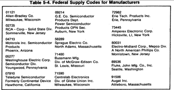

I swear I’ve seen a table that names the manufacturer for a given mfgr supply code in the Fluke service manuals, but of course I can’t find it anywhere. I’m looking for manufacturer 89536, but I’d prefer to know where the table is. _______________________________________________ Techtoolslist mailing list Techtoolslist@flippers.com https://pairlist7.pair.net/mailman/listinfo/techtoolslist FTP site is: ftp://ttl.arcadetech.org/TTL/Test_Equipment Archive site: http://seven.pairlist.net/pipermail/techtoolslist/

(easier to find here) The cross-reference information is located in the 8020A_Multimeter.pdf file under /Fluke/Fluke Test Gear in the TTL FTP archives, Page 5-10, table 5-4 Federal Supply Codes for Manufacturers 89536 is Fluke themselves as the manufacturer, see screen capture attached... John :-#)# -- How to subscribe or unsubscribe from TTL http://seven.pairlist.net/mailman/listinfo/techtoolslist _______________________________________________ Techtoolslist mailing list Techtoolslist@flippers.com https://pairlist7.pair.net/mailman/listinfo/techtoolslist FTP site is: ftp://ttl.arcadetech.org/TTL/Test_Equipment Archive site: http://seven.pairlist.net/pipermail/techtoolslist/
89536 is Fluke themselves as the manufacturer, see screen capture attached…
Well, that’s unfortunate. I have a unit with sync high/low keys which don’t lock, which I was hoping I could find off-the-shelf replacements for.
There is a post on eevblog from an ex Fluke employee regarding 89536: http://www.eevblog.com/forum/testgear/old-fluke-multimeters/msg326324/#msg32... On Feb 1, 2016 9:55 PM, "John Robertson via Techtoolslist" < techtoolslist@flippers.com> wrote:
